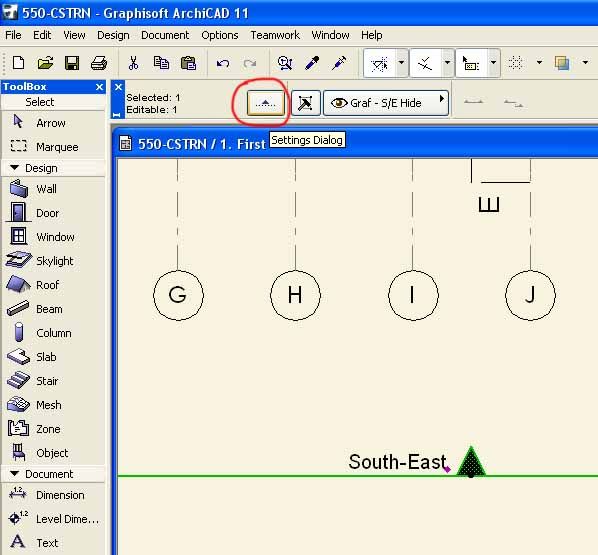

Imagine that i want all the page with no shadow...
4 Replies 4
I assume you mean how to turn off shadows in elevations.
In the elevation (and section) settings uncheck the box marked 'Vectorial Sun Shadow' (highlighted in blue, below)
sorry... I didnt Find elevation (and section) settings to uncheck the box?
The settings button is positioned in the same place it is for all the tools. (ctrl+T does the same thing)
Make sure you have selected the elevation line first, otherwise you wont see the button!

You can also right click on the view of the relevant section/elevation in the view map/project map and get to the settings ...
