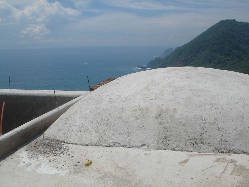

Hi to all,
I hope somebody might help me with this,
I need to make this dome and has a rectangular base, what is the best way to build it?
The picture that is attached is dome during the process of construction, it has a rectangular base of 4.5 mts x 5 .5 mts. with a height of 1.10 mts.

Here is another picture of the dome
Dwight
Use the mesh tool with contours.
Draft out the dome shape and profile.
Use descriptive geometry in the profile to establish each contour.
Dwight Atkinson

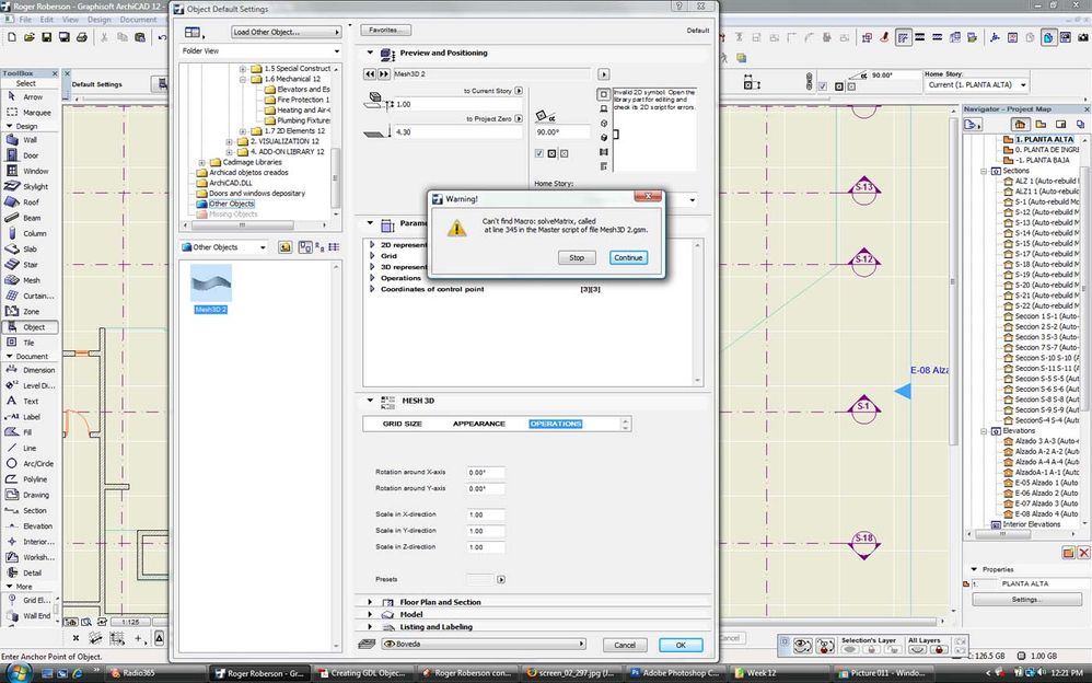

Try Mesh3d by Petri... Works like a charm.
Thanks Braza,
I downloaded the Mesh3d but I can't make it work in a dome shape, will you be kind to explain me a little how it works?
Thanks
You are welcome Rucailo.
Here it is...
1. Select the preset shape in the "Operations" menu;
2. Go to the 3d window and adjust the shape with the editable hotspots.
That's it.
When I select in the operations menu "VAULT" it send me an error message as this one, what to do?
Thank you very much for your help, I think this is a great object to work with, I do a lot of domes and if I make this work will be great for my office,
Thanks again
It looks like it only works with the "SADDLE" option
