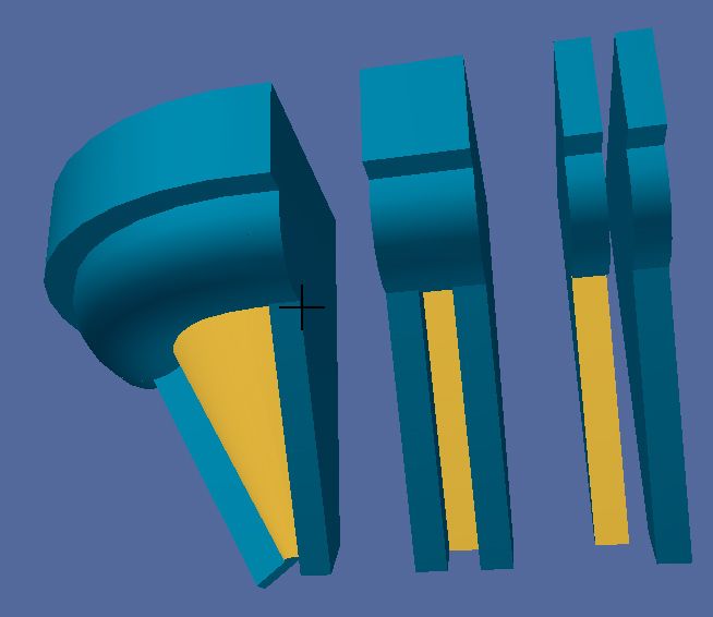

Molding = one or more custom profiles (upper and below) to have both turn 90° individually at the corner...
Posts : using different slabs in plan view and save as an object (see image)
Etc...
So do you save that as an gld object then or just group it so its easier to multiply?
You can do this with one piece, and than use SE. In this case you dont have GDL.
I do save as a GDL object (via Generic Axonometry window) to have it turn 90° : File > Libraries and Objects > Save selection as... and make it an editable script to change materials if needed.
Then multiply the object in plan view.
I would use slabs also to get the storefronts as shown (as a carpenter would assemble them)
Dwight
Many objects can be more simply made with Custom Profile Walls - no rotating and only save as an object if you need it again.
Several advantages include individual surface materials.
