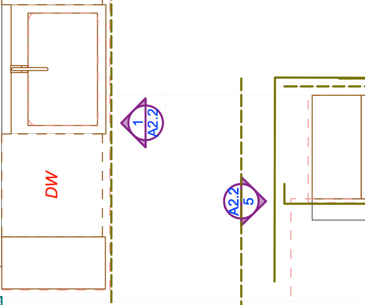

Can I get the marker head to rotate in an IE? The way the text is split reads a bit backwards. How about hiding or changing the cut line type?

On the marker tab there is a setting Marker Text Rotation where you have 3 options. Will this do what you want?

Oop! -- I must have looked right at that thing. Thanks.
Any way to hide or change the line type?
Geof:
These lines are an On-Screen Display Option, so they won't print, and can be turned off by disabling Marker Range. Their line type and pen are set under Project Preferences > Miscellaneous: Line Type and Pen of Markers Elements' on-screen-only parts.

Fantastic -- would have taken me a while to find that one.
