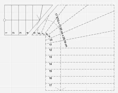

L-stair with different flight width?
Kind of embarrased I don't find the obvious way to do this stair with different flight widths. Thankful for help 🙂2024-10-10_16-50-17.png

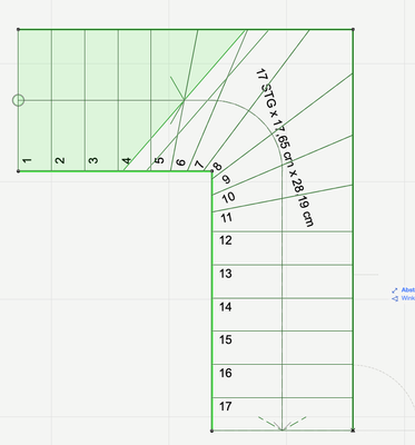

runxel
You'll need to go for the bold green outline (try not to click on the side with the reference line).
Then you can modify the outline of the stair and make one of your flights smaller/wider.

Mats Knutsson
Ah the subtle "mutiple elements"...thanks!
