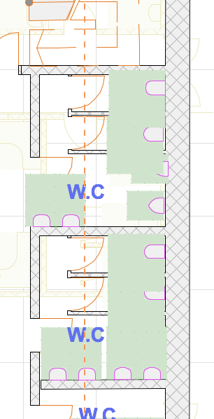

Large green square around object
Hi guys, i know this is probably a really easy solution, whenever i place a object, WC , Sink etc, there is a huge green square around 4 or 5 times the size of the object, it kinda gets in the way, hides doors etc, Anyone know how to get rid? much appreciated as always. Paul
3 REPLIES 3
It depends on the particular parts but it looks like there is a parameter turned on to show access/clearance requirements. Check the parts' parameters in the settings dialog.
Look for the "minimal space" option under 2D representation settings for the objects.
If you are using AC13 (or later) then minimal space settings are found in the Model View Options Dialog.
