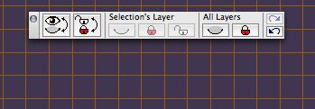

When i click "Quick Layers" I get this palette
Sorry mate, just being a sarcastic punk again. The name of the palette is Quick Layers, so it makes sense that it controls things by layer. Even the button you made mention of.

So just to be perfectly clear, tool naming flaws aside, that the Quick Layers palette has two buttons on the left hand side that control element visibility and locking state independent of layer.
Wow. Are you sure those buttons don't just switch the visibility and locking of all layers?
If they adjust locking on an element level, I'll eat my shorts!

Dwight
You are right, altho when i did it earlier i woulda sworn...
