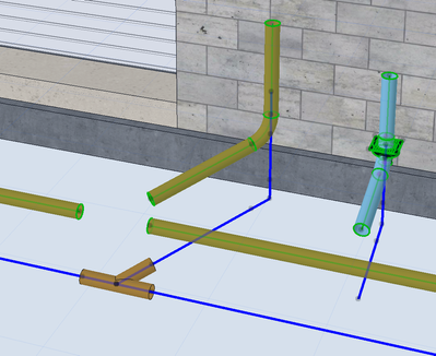

Hi Balint,
Thanks for looking at these points.
1. I have now found the missing objects. But adding a double Tee or Wye to a sloping or vertical pipe using the Pipe Fitting Tool isn't possible? There can only be a single connection when joining pipes onto a run?
2. Someone suggested not long ago that removal of nodes in polygons & poly lines should be removed by double clicking. I like that suggestion, especially if there is consistency between tools. The drag option can in some situations generate unexpected outcomes.
3. That's not what I am seeing and if I use the context [Relink home storey] menu item then the elements change their height - they shouldn't with that option!  Perhaps sending you a copy of my PLN file would help identify some of the display problems?
4. What I was looking for was to take a run of pipes containing different slopes between nodes and average them from the lowest to the highest point so all the slopes are the same e.g. I have three segments of equal length but different slopes of 10mm/m, 30mm/m & 20mm/m. I want them to adjust so they are all set to 20mm/m either by AC doing the averaging or letting the user set the slope with the node heights adjusting automatically.
A couple of more points:
Undo/Redo doesn't seem to function correctly e.g. the results are consistent with the previous state.
Placing pipe parts don't associate with the connected run.
Balint Kezer
My answers to your points:
  1. It is possible to add any kind of Fitting to a sloped route and these elements will become sloped as well:
  2. Yes, that could be a way of doing it, but it still not addresses what should happen to labels, when each side of the pipe/duct is labeled.
  3. Yes, please send me your file, I would be happy to check out the issue you described. As far with the relinking we are aware of that issue.
  4. Currently there is no such smart functionality, but I'm interested to hear about your opinion of the best possible sloping workflow.
  5. What are you trying to undo that does not work?
  6. Are these pipe parts in the same system? Connections only stand when the system is the same between the ports of the elements.

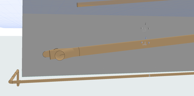

@Balint Kezer Thought you might like a further update...
I have deleted all my zero & intermediate height story levels to simplify adjusting the pipe routing and hopefully finally be able to present that information in 2D. Guess what happened to the pipe junctions on the lower story beyond what was deleted, yes, you guessed, the junctions moved and the pipes stayed in place. So much for the "system" and coordinating everything.
I'm now heading back to fix all my pipe runs again. Three days to do what should have been a three hour job. 🙄
Can you explain this?...

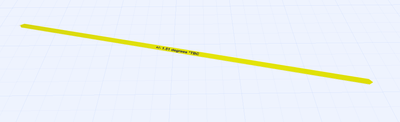

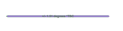

I made a 2D/3D slope object you might find useful.
Here you go:
https://www.icloud.com/iclouddrive/021nt78szVcd_W900usUG-ROA#2d-3d_gradient_label
It looks like this in 2D:
And like this in 3D:
It's pretty configurable.
You drag the origin onto your object/mesh, and adjust the hotpot at the other end to set the length and 3D height.
There are lots of people here who can make this a lot more usable. It does what I need it to though.
