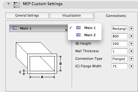

I am very new to the MEP modeler. I have a couple of questions so far.
1. How do I create a duct bend with different connection sizes? The connections have the same height, but different widths. Is this possible? or do I have to model a transition as well?

David your duct bend is easy.
On the bend dialogue box under "MEP Custom Settings" select the "Connections" tab
In this tab you will see a button saying "Main 1" - this is your inlet connection size.
Click on "Main 1" and you can choose "Main 2" which is you outlet connection size. You can select it the same as Main 1 or give it different sizes
