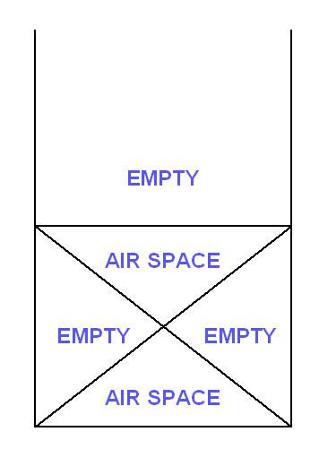

ERIKA:
SO MY PROBLEM WAS WITH THE WAY I WAS TRYING TO SHOW THE TOP AND BOTTOM PLATES IN SECTION.
I HAVE NEVER HAD A PROBLEM WITH THIS BEFORE.
THE WAY I SHOW THE PLATES IS TO USE FOUR TRIANGLE SHAPED FILLS THAT DON'T QUITE TOUCH SO THAT I SEE THE "X" WITH A RECTANGLE AROUND IT IN SECTION.
I THINK WHAT I DID WAS MAKE THE SPACE IN BETWEEN THE FILLS TOO SMALL.
IT WASN'T A REAL FRACTIONAL INCH, IT WAS JUST ENOUGH SO THAT I COULD SEE THEY WEREN'T TOUCHING WHEN I WAS ZOOMED IN AS FAR AS I COULD BE.
SO, AFTER 3 HOURS OF MESSIN' AROUND WITH THIS DAMNED WALL I WAS DOWN TO THAT AS ONE OF MY LAST OPTIONS. FIDDLED WITH IT A LITTLE BIT, AND NOW IT IS BETTER.
THANK YOU THOUGH.

4thorns wrote:
Is there a reason that you would use triangle shaped fills instead of a couple of lines? I brought all this up because I haven't found a good wall framing tool and am looking for ideas.
Lines can only be used for drafting purposes within the complex profile, and hence do not show up in section. I presume he uses four separated fills so that they don't all heal when they touch. If you use different opposing fills (such as air space and empty fills), there's no need to include a space.

Yes, in the section window we can embellish with 2D elements 'til the cows come home. The point with complex profiles is that the detail is part of the wall, so that when we cut a section through it, the information is already there.
I remember first alpha testing complex profiles and suggesting to GS that it would be wildly valuable to allow us to include full 2D embelishments as part of our complex profile, including even labels and dimensions. So that when we cut a section or a detail through the profile, all the information was there and no further embellishment would be required. Obviously it would need visibility control and allow for further editing, but I think it all got too hard for them. Or maybe it's just another silly idea!
