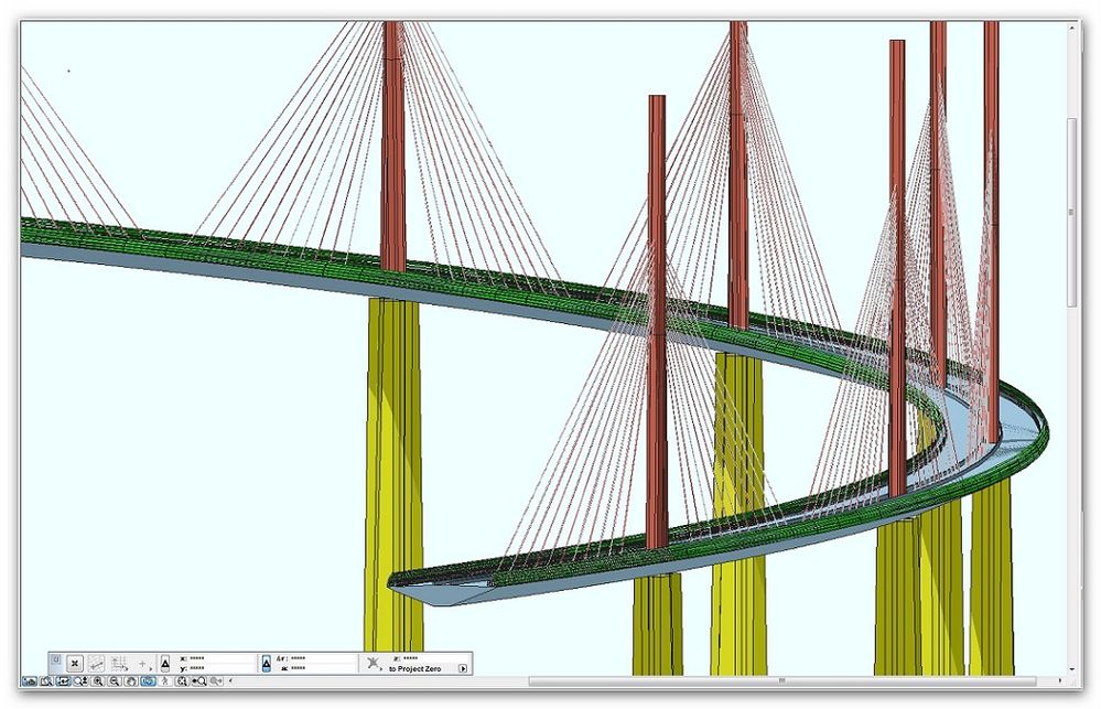

Is modeling a terrain model with roads and a bridge. Someone who has a good idea of how to make a bridge? which object should I use?
I use ArchiCad 15.

It would help if you told us what kind of bridge.
Concrete, suspension, steel truss, cable stay, etc .
Peter Devlin
Well, I model the Millau viaduct (FRA) - 2460m long bridge with walls, slabs, complex profiles, objects from the library + Encina Objective Add-On.
