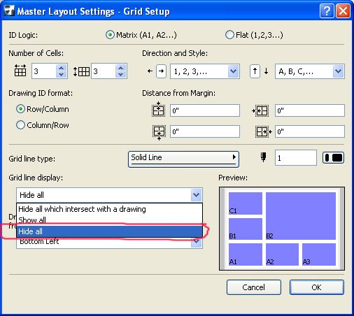

Does anyone know how to make it so this grid does not print. I want to use the NCS grid for laying out and assigning drawing numbers, I just don't want it to print. Any thoughts?
Thanks!
-Chris

In the settings for the grid of a master layout you have the option to hide all the lines.
undefined
Erika

DUH! Thank you!!
