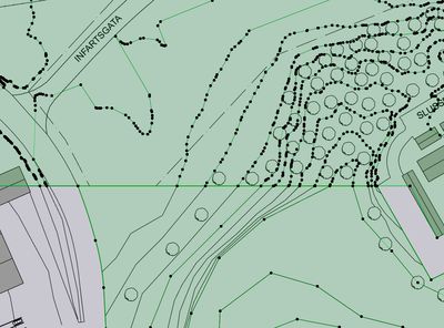

Hi, is it possible to merge meshes in Archicad ? or is still problem continuing ? 😄
I made a model of land and I did extension after. I would like to merge two meshes.
If isn't possible can i get rid of border lines between two meshes at least and keeping curves lines visible?

Do you select your first mesh, click on a peripheral segment, choose the "+" option and finally press the space bar before clicking on the other mesh ?
This method will not merge meshes but will nevertheless make it possible to recover the influence of the second mesh. Otherwise I can advise you to hide the outline of the two meshes and then to redraw in 2D the global outline of the two meshes to create the illusion of a single mesh.
Or you can create a Patch to draw over this line. I agree with you it is not a great solution but you are able to get your aim by this way.

Thanks Shristophe, this solution make just flat terrain.
It's mean that skip all the curves with highs information.

Or course my first solution means that skip all the curves with highs information.
Did you consider my second proposition ?

I didn't get it second solution. Did you mean like hidening lines by using fills and put above it ?
If is this all possibilities how to reach that how you said both solution is not elegant 😕

Hidening lines with a patch yes. The line is the problem, hide it !
It's a elegant but not a great professional solution 😉
