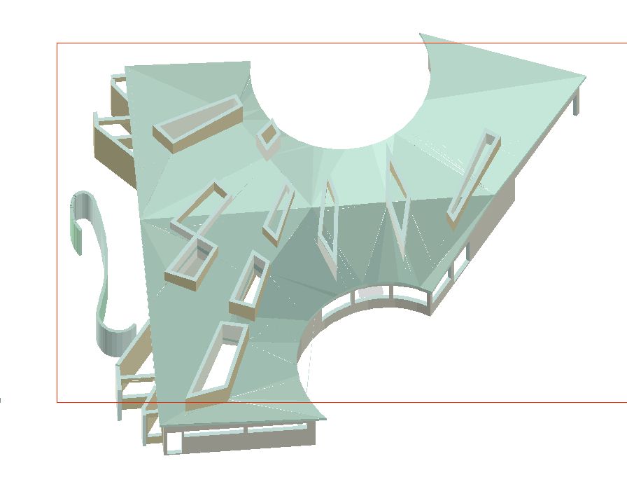

Now with the SEO successfully trimming walls and skylight wells, I've encountered another problem. This roof consists of two meshes(I tried to make it a single mesh) which meet at the center ridge. I have been creating holes for the skylight wells (as seen in the lower left), but am having trouble with the wells that traverse the ridge and occupy both roof planes. I have tried to create two separate holes on each plane, but this creates an open polygon and makes the entire roof plane disappear. Is this a good time to use the 'mesh to roof' add-on?
garytom,
You shouldn't use the make hole command if the hole will
intersect the edge of the mesh.
Use the subtract from mesh pet pallet option.
Peter Devlin
