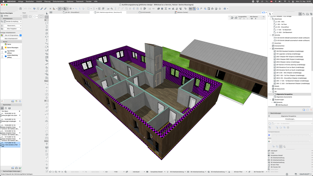

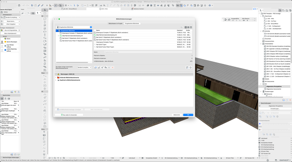

Hi there,
I am using Archicad 24 and I am having trouble getting the standard attributed to show on my 3D view.
I red few articles about missing attributes but none of them seemed to be matching my scenario.
Also, I am using the German version of Archicad which makes a bit more difficult for me to understand how to get around these inconveniences.
Thank you in advance for your help and please let me know if I can provide you with more info.
SavinoScreenshot 2021-09-13 at 18.07.53.pngScreenshot 2021-09-13 at 18.06.50 (2).png

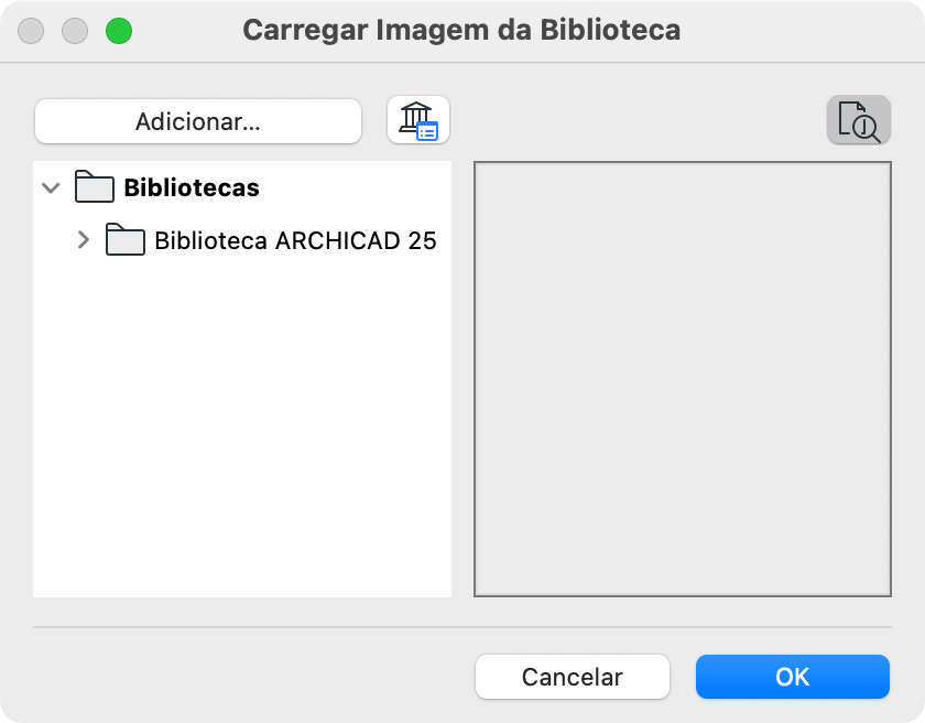

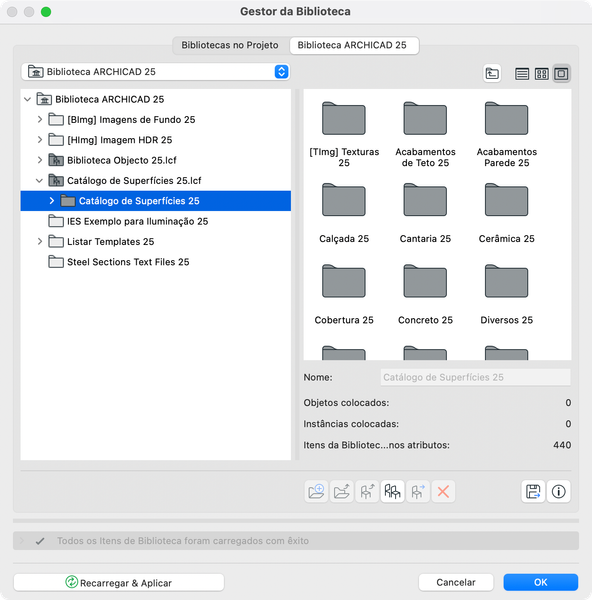

Hello @Savino, you are missing the image files from the textures.
You can add them by adding the German Surface Catalog to the file by File > Library > Library Manager and add the whole German Surface Library
Or add the image files one by one, you need to go into Options > Attributes > Surfaces and List the surfaces to Import these files.
Hope this can help you 😀Screen Shot 2021-09-13 at 13.25.01.pngScreen Shot 2021-09-13 at 13.25.11.pngScreen Shot 2021-09-13 at 13.25.29.png

Hi @Vinicius Guedes,
Thank you for your time and explanation, which has helped me to understand that I already have a Surface Library installed which means that the issue that I am experiencing might be related to something else.
I have tried to duplicate the Surface Library into the embedded library just to understand if Archicad was using a different path to avail of different libraries. However, it didn't work.
I have attached a few screenshots in case, by looking at my libraries and folders, you can understand what could be the reason behind this inconvenience.

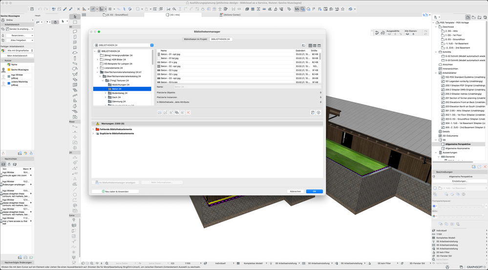

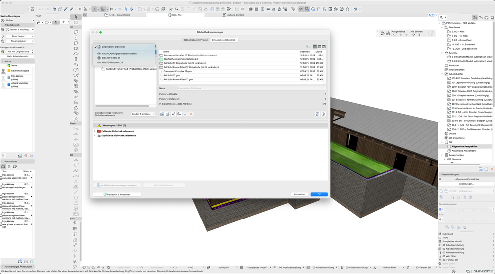

Thank you again.Screenshot 2021-09-14 at 09.12.24.pngScreenshot 2021-09-14 at 09.12.44.pngScreenshot 2021-09-14 at 09.13.06.png
Have a look at the tab for 'Libraries in Project" (Bibliotheken im Projekt).
That might show you what library is missing - which is the one you need to load.

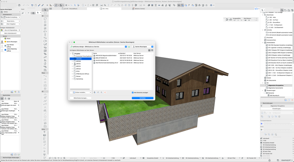

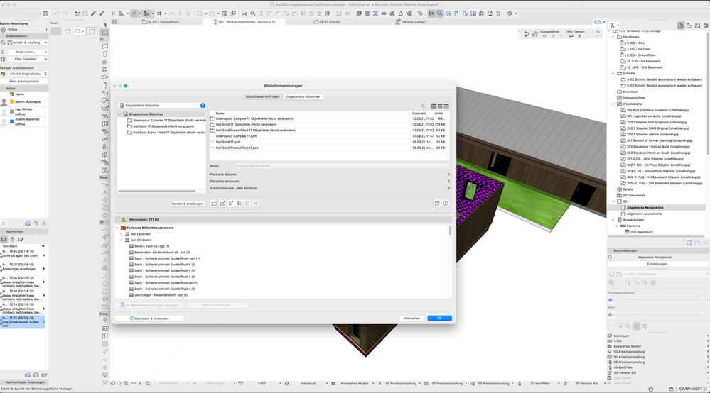

Hi @Barry Kelly,
I have tried to have a look at the "Libraries Project" (as per your suggestion, but I cannot see anything that stands out for this issue.
I have also tried to open the BIMcloud Library and I have tried to upload the "Surface Library" in the "Libraries" folder just in case for this specific project, Archicad was using a different path. However, it didn't work.
What I have just noticed is that this issue applies to this specific project which is running through BIMcloud as I am working in a studio environment.
I just would like to highlight also, that everytime I have uploaded the Surface Library to a certain folder I have always restarted Archicad.
I hope that any of my info could be helpfulScreenshot 2021-09-14 at 10.16.57.pngScreenshot 2021-09-14 at 10.15.58.png to get at the bottom of this issue.

Hi everyone,
I just would like to let you know that I have been targeting the missing Surface textures and I have manually re-uploaed the missing attribute, it worked.
I just don't understand why Archicad is not able to recognize the image path for this project.
I will just let it be for the moment and thank you, everyone, for the great support.
