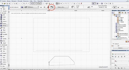

Hello guys! I have quite big problem, I was working sinc this year with archicad 12 and now I am using 18, I cant find this button ( in the picture)
Can anyone help me?

Hard to tell from your small image, but is that a curved roof option? There have been a lot of advances since AC 12 including the Shell tool and the Morph tool, both of which are available in AC18, and might do what you need. Check them out.

Yes it is curved roof, I will try Morph tool because Shelltool doesnot for me in this case! Thank you
Yes the shell tool was the replacement for the curved roof.
You can create a tube or a dome and edit the shape of the profile.
