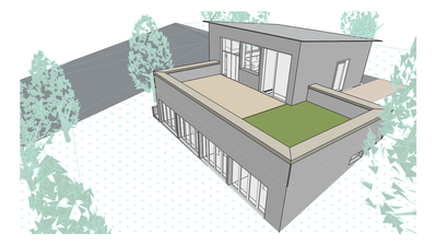

I recently came across a project from my first year as an architecture student, and since the paper model I had is long gone, I thought of modelling it with Archicad so as to keep record of it for my portfolio. The building is a 2-story family house, on a sloped site. What I had at hand was purely hand-drawn documentation as a starting point to recreate my project, which made bringing it digitally to life very interesting.
I will detail below the modelling and documentation workflow, from which you will be able to get some indication and some visual inspiration if you ever find yourself having to perform a similar task, or simply wanting to recreate and experiment on your own projects.
To do this I have divided the process into 5 main phases. At the end, I will give you some tips, and considerations that I think would improve the described workflow.

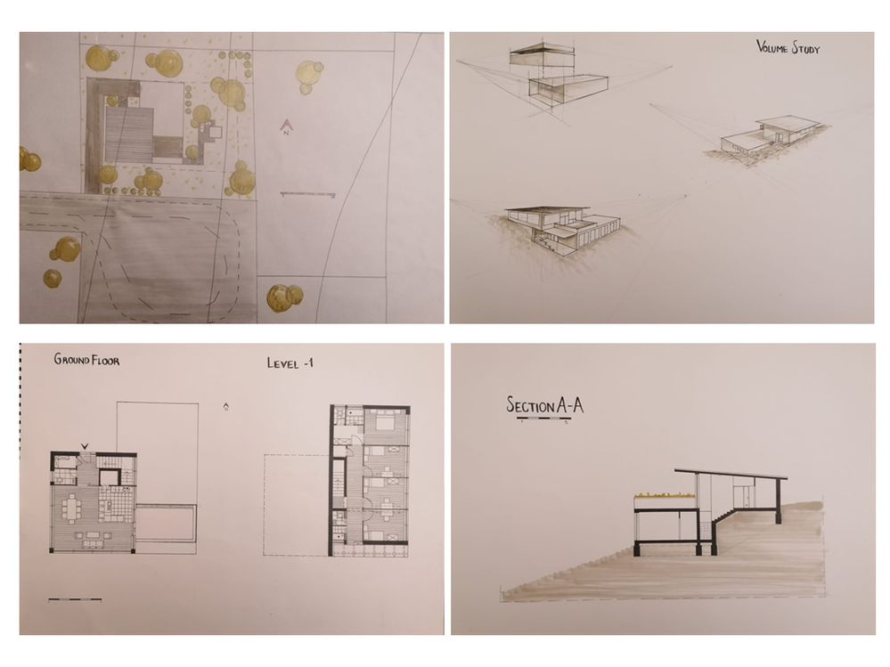

Phase 1 - Mapping out the project and preparing the file
This stage was mainly for setting up the foundations and systems that I followed throughout the modelling process. Making sure that elements are classified, and some attributes are set early on in the project will save us time and allow us to focus on creating and documenting rather than fixing mistakes as we go along.
- Reviewing the hand-drawn plans
- I had perspective sketches, floorplans, sections, and elevations on a 1:100 scale, as well as a site plan with 1:200 scale. All of these, containing some general dimensions and drawn with ink.

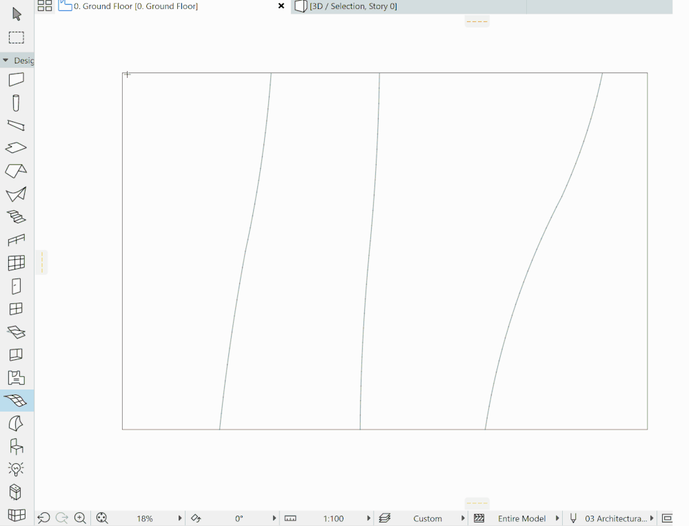

- Modelling terrain
- Modelling exterior walls
- You might already be familiar with this simple process, choose a consistent reference plane to create the walls, and as mentioned above, make sure they are placed on the correct layer and have the correct classifications.
- You can crop the walls later on, when you have created a roof.

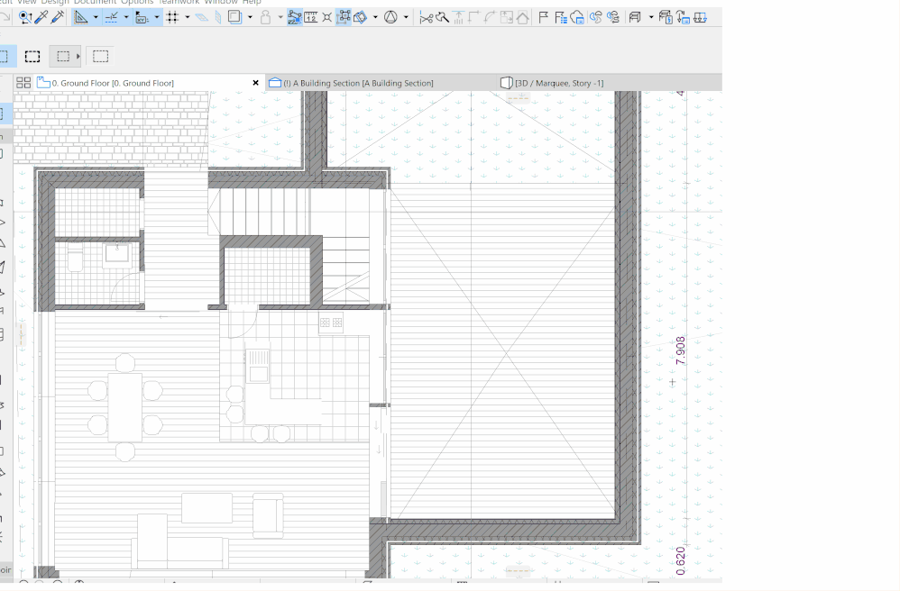

- Adding partition walls and parapet walls for the flat roof/terrace
- Windows, openings, and doors
- Use the corresponding tools for these ones, or experiment with curtain walls.
- You can use the 'Model view options’ panel to control the level of detail for these too (I’ll expand about this one in phase 4)
- And do not worry about individually modifying the line colors for now, we'll handle all of those with graphic overrides later on.

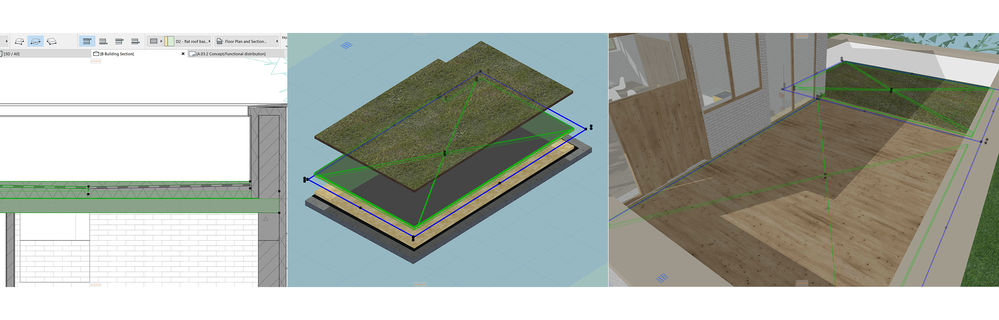

- Modelling flat roof
- I modelled the structural slab with the slab tool, and I made the slanted drainage system of the flat roof using the roof tool and custom composites.
- Checkout this article, it describes a very similar process to the one I used: How to Create a Flat Top Roof - Graphisoft Community

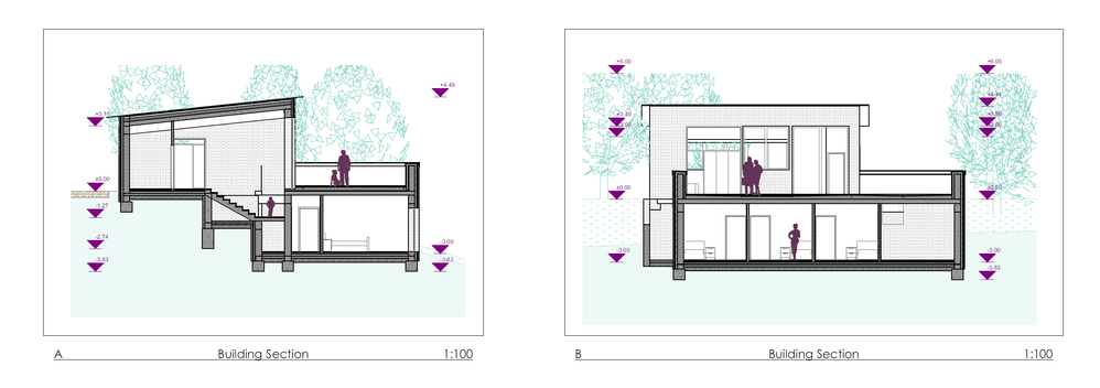

Phase 5 - Final Documentation
In this section, you will work using the View map and the layout book for the most part.

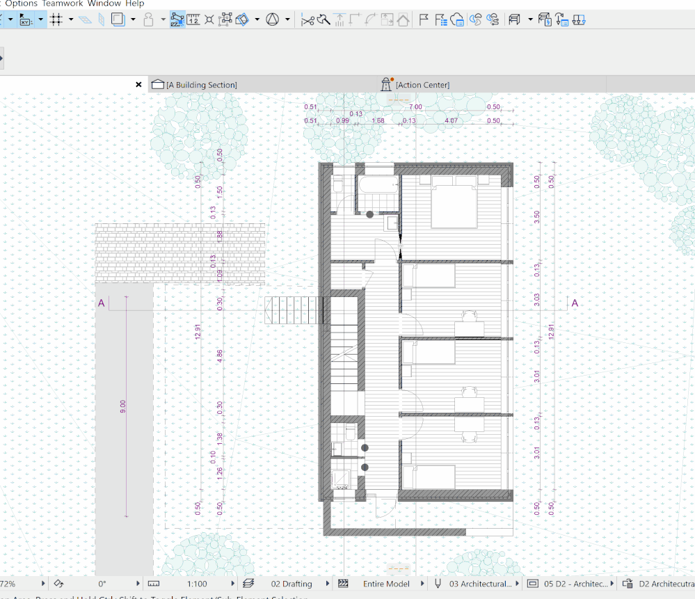

- Add dynamic annotations and dimensions to your construction documentation views.
- 3D documents.
- You can control display projection of the model, making it perspective or axonometric.
- The 3D document settings allow you to control the appearance of the model, such as surface appearance, textures, lines, etc.
- 3D documents allow you to play with different illustration styles. When you create a 3D document, element attributes are still active. Once you change the document settings to 'drawing', it will turn into a vectorial image that you can edit using 2D tools.

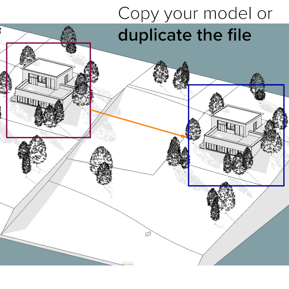

- Making an exploded axonometry:
There are 2 ways you can tackle this one:
- Copying, pasting, and moving around
- Copy your model, and move it far away from your origin, then you can displace the elements as shown In the sequence below.
- The disadvantage of this is that as you will have duplicated elements and your project could get messy. You could put the model copy in different layers, but you would have to manage the override rules carefully.
- The best option might be to simply have a duplicated .pln file of the project to create these model views, and hotlink these to the layouts of the original .pln.

- Making your own pen sets and pen types in the ‘Pen and color’ panel - You can create some nice outlines and fills with these. Learn more about these: Pen Sets - Graphisoft Community
- Dimensions and Annotations.
