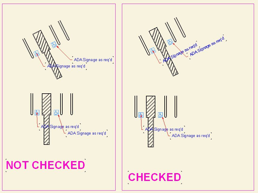

If you UNCHECK the box, labels and zone tags will stay at the same angle they were originally placed. If you check that box, label text and zone tags will rotate with the module.
-I wish we could separate the choice for zone tags and labels.
-I wish one choice would be to allow us to individually rotate label text as needed when rotating a module.

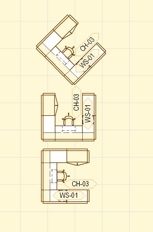

Laura Yanoviak
So an exception would be Labels placed with "Use symbol arrow" aka without a Pointer. I think the Labels' orientations should behave the same regardless of the "Use symbol arrow" setting.

Laura Yanoviak
OK -- I unchecked "Use symbol arrow" and assigned the Pointer an 'invisible' line type and made the arrowhead small and white. Yet another goofy work-around...

Erika Epstein
I'm not sure which label you are actually using, so this may or may not apply.
One of the somewhat counter-intuitive settings is the 'USE SYMBOL ARROW'. For the type of symbol you show, NO arrow is the symbol arrow so checking that box will turn OFF the arrow and its lead.
