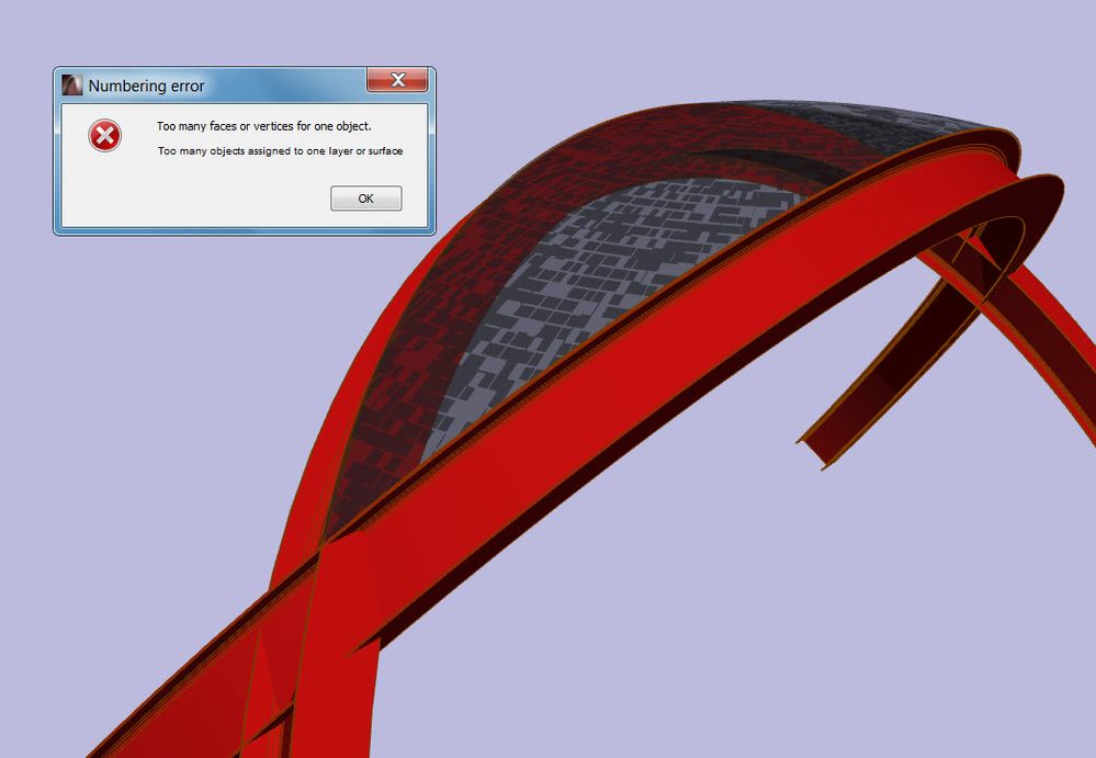

Steve Jepson
I feel your pain Bonnie.
I really don't like seeing messages like this either. As when I am making something I want to be very smooth like a piece of glass.
