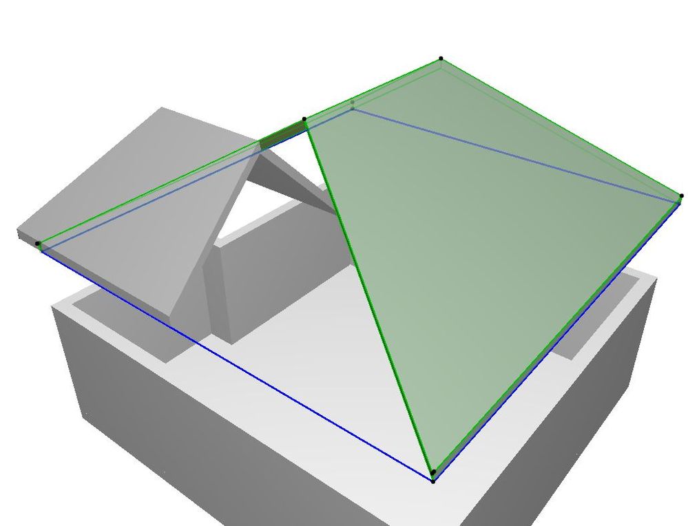

I keep having this issue where roof planes disappear whenever I try to adjust the nodes of a multi-plane roof. Sometimes the roof disappears altogether. The missing plane is set to pitched, not gable, so it must be something else.
Tried this in both AC 25 and 26, same issue.

Actually I figured out the issue. I was modelling based on a cad drawing I had imported at the wrong scale. What I though were millimeters were in fact meters so the roof was acting strange due to the x1000 scale. Works fine at 1:1 scale.
Sometimes It's the mistake you'd never expect you'll do...

It looks like there is a double hotspot in the corner of the section of roof that has disappeared at both ends. have you accidentally inverted it?
