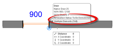

Hi, Object(windows, door) becomes not selectable after "USE FILLS" are disabled from "Floor plan and Section" from settings. Is that ok behavior? I don't fint a place where to click to select them after disabling fills, even thick lines not going to help.

No problem with the selection.
You should see 'Multiple Elements (TAB)'.
So just TAB to cycle through the doors.
First when hovering the mouse you should see this - the door to be demolished.
Press TAB and it will select the other door.
Interestingly though, when you press TAB and the other door high lights, it does not show the renovation status in the info box.
But it does select the correct door if you now click to select.

I am having no issue selecting the doors - no matter what renovation filter is active.
Any of the points shown by the black dots will select the door, as well as the purple moving hotspots.
If existing and new doors are shown together, TAB cycles to the one you want to select.

2022-02-27 08:35 AM
@kosta , I removed the file link as it just bombarded me with messages and my ant-virus was saying malicious content.
I wouldn't use that file sharing service.
