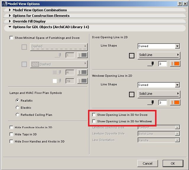

Hello everyone,
I am having touble removing the opening lines of doors and windows in section elevations and in 3d views?
I cant find the option to not see them
Thank you in advance
1 REPLY 1
Hey Wendy,
Try going to Document > Set Model View > Model View Options > Options for GDL Objects and uncheck the "Show Opening Lines in 3D for Doors / Windows" options.
Hope that helps,
Adrian Tudoreanu
