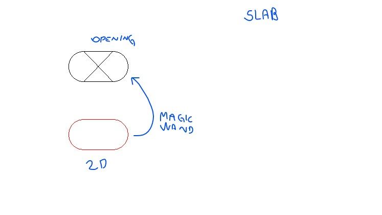

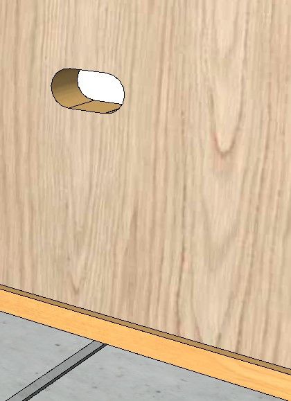

I have a custom profile that I use for creating holes in CLT-panels. I would like to use the opening tool instead to create these holes rather than a beam with a custom profile.
In plan view and on a slab I can paste the custom shape and use the magic wand with opening tool to acheive this, but I cannot save the shape as afavorite and thus not use it on walls.
I have tried a work around and use "Connect/Create opening from selection" however the shape of the custom profile is translated in to the nearest circular or rectangular opening (in this case a rectangle).
Has anyone been able to save a custom shape for the opening tool so that it can be used on walls?

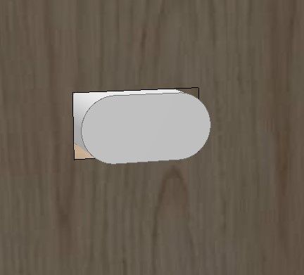

Thanks for your quick reply Christophe!
It is a good suggestion that I had forgotten existed!
However the window shape is for some reason still translated to a rectangular opening...

@CarlM Wallhole only ever creates a rectangular opening. Expanding on @Christophe Fortineau suggestion, you need to create the wallhole but add an infill that forms the hole profile.
See if these two links help...
https://community.graphisoft.com/t5/Design-articles/How-to-create-Custom-Window/ta-p/303432
https://helpcenter.graphisoft.com/graphisoft-archives/25570/
DGSketcher - thank you for clarifying Christophe's suggestion!
I had over looked the importance of "WALLHOLE" as ID - makes all the difference!
@DGSketcher & @Christophe Fortineau - thank you both for excellent guidence and clarifications! Problem solved!!
