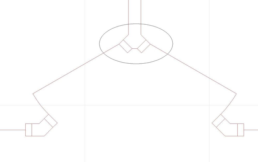

I've just started working on an new project and I've got a problem with three walls I'm trying to connect to each other. I'm posting a picture of my problem.
EDIT: The lines in the picture is a AutoCad drawing.

If you connect the walls with the reference (bold) lines as the drawing below it should work correctly. Make sure the vertical wall is set to the centerline method of construction.
Turn on the reference lines in the on screen view options to help you.
Thank you Peter!
You help worked!
Guess I owe you one
Thank you once again
