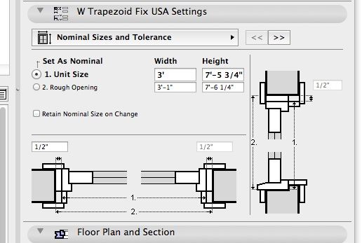

For some reason the window only lets me set the rough opening dimension for one side. The opposite side and top are grayed out. Is this the case with you?

Also the unparallel frame lines happen when I make the window larger than the default size. For instance, I make the unit 7'-0" tall, and the shoulder 6'9" tall, and it "gets all funky".
