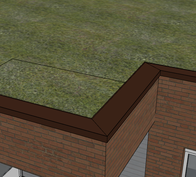

I'm having trouble exporting complex profiles from AC to IFC. While the profiles themselves are exported correctly, the intersections are simply left out. Does anyone have a solution to the problem?
I'm including screenshots of the same corners, both from AC and an IFC viewer.

Hi
you might want to check your ifc export settings. Look out for the geometry conversion options. BREP is the geometrical more precise option, which might resolve your issue.
For further information check out this helppage and read into the difference between BREP and Parametric (Extruded / Revolved)

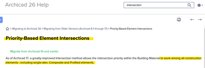

‎2023-08-22 02:06 PM
From my understanding it affects all priority-based intersections, not just complex profiles.
And here a definition of priority-based intersections:
and the in-depth of possible intersections
