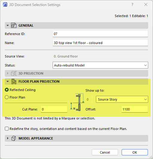

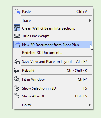

The 'proper' way is to right click in the floor plan and save as a 3D Document.
Then in the 3D Document settings you can set it as a reflected ceiling plan and adjust the cut plane heights.
I have never used it so can't recommend any particular settings.
But as you are wanting to show furniture as well your offset and cut plane will basically need to be at floor level.
