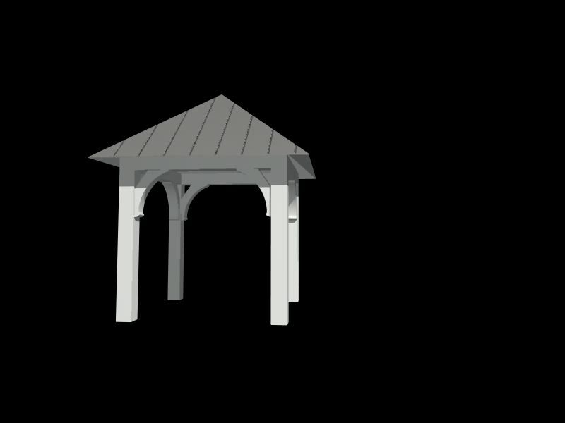

Anyone have a good process in drawing a "gazebo" roof framing for lack of better words? The plan shows a pyramid roof at 10:12 on all sides, 9' square. The model will show the open rafter ceiling, with decorative ends to the rafters.
It seemed simple in theory but it's becoming more difficult to do, or figure out rather.
I thought to make a custom profile and extrude the thickness of the rafter, but I cannot modify that profile to stretch it for the corners that are deeper and take....I will just post a photo of what I am doing.
What's missing in the photo is the decorative rafters.

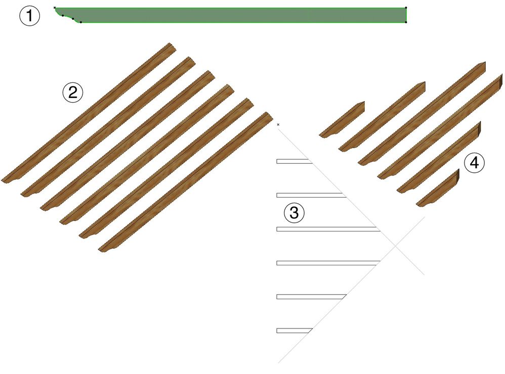

This is easy with OBJECTiVE. Following the attached image:
  • 1. Draw the shape of your rafter using a fill or slab and use OBJECTiVE's profiling tool to make an elevation profile object from it.
    2. Use 'OBJECTIVE/Tools/Rotate' to incline it to the pitch of your roof and multiply it at whatever rafter crs you require.
    3. Use 'OBJECTiVE/Tools/Split' to cut the rafters to the hip
    4. The finished result in 3D.

Have you tried making them all the same and then just using the adjacent roofs to SEO the ends of the rafters?
ArchiCAD 26; Windows 11; Intel i7-10700KF; 64GB RAM, GeForce GTX 3060
Jere
I just tried it and it worked great. However, you have to SEO twice, once with upwards extrusion and once with downwards extrusion to get the rafters to clean up properly.
