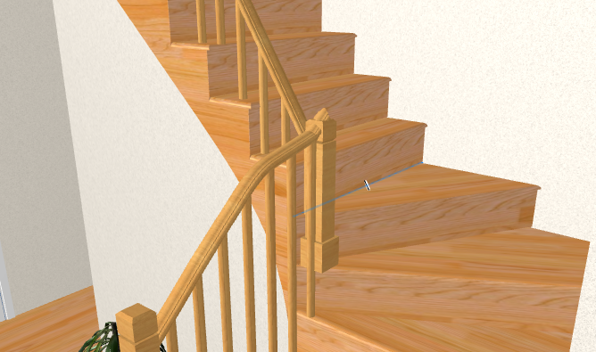

I've used many stairmakers before, they all fail to create a correct looking railing for a L Shaped staircase with winders. I was hoping ArchiCAD's new railing tool could offer a solution, yet after playing with the settings for hours, I still end up with an ugly turning. I've tried editing the railing but to no avail.
It seems that most of the stairs in the demo have landings instead of winders, could it be that the algorithm for railings on winder staircase isn't well tested? Why won't the railing automatically add a vertical segment to the top rail to connect to the post on top of the winder as done in real life? Or have I missed something?

Thanks again, your screenshots made it very distinct, I totally have everything under control now
My mistake was that I placed the two nodes on top of each other in 2D instead of 3D, resulting in them merging. By placing the nodes in the corresponding positions in 3D the railing behaves in the same manner as yours.
During the operation, one of the node will control both the upper and lower L baseline, the other node will control only one of the two base lines, which makes things a bit confusing, but as long as you place them in the correct positions things will work out.
