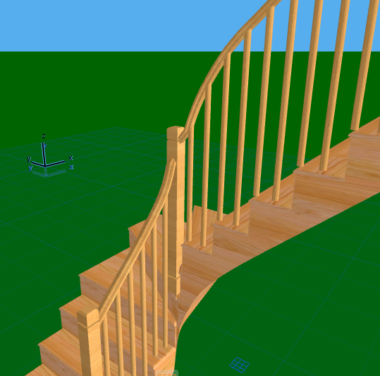

After some trail and error I end up with this, still not right... it'll work for far away renders but upon close inspection no carpenter would find it pleasing ( curvature in top rail is too complex )

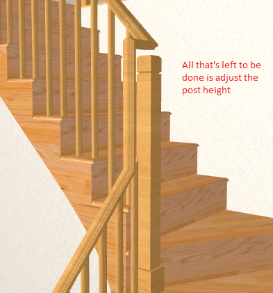

This is what I mean by manipulating the baseline nodes in 3D.
You need the baseline to follow the top of the stair flights.
The image on the left is the automatically associated nodes when placed with the magic wand.
One node needs to be lifted and a second one created so you end up with 2 nodes in line vertically at the winder.
The middle image has the 'disconnected' top rail and the one on the right has the 'gooseneck'.
The end post node will need to be adjusted individually so it can have an offset, to move it up the stair a bit.
The winder post remains as a single post with no offset.
The heights of the post can also be set separately by selecting them in the 'Edit' mode.
Once you start adjusting nodes/post individually you will notice a small yellow warning triangle in the railing settings next to the nodes.
This means you can no longer change the overall settings of the railing (like connections) as they will have no effect.
You have to go into 'Edit' mode and select the parts you want to alter and go into the settings for those parts.
So to edit the connection you have to go into 'Edit' mode, select the top rail then TAB on the end hotspot until you get the 'Top rail connection'.
It can be a bit of a challenge sometimes.
Otherwise press the "Reset" button at the bottom of the rail settings then OK, then you should be able to make global changes to the rail again.
You will have to adjust your post heights again and possibly even move the baseline nodes as well.
It is all a lot of experimentation.

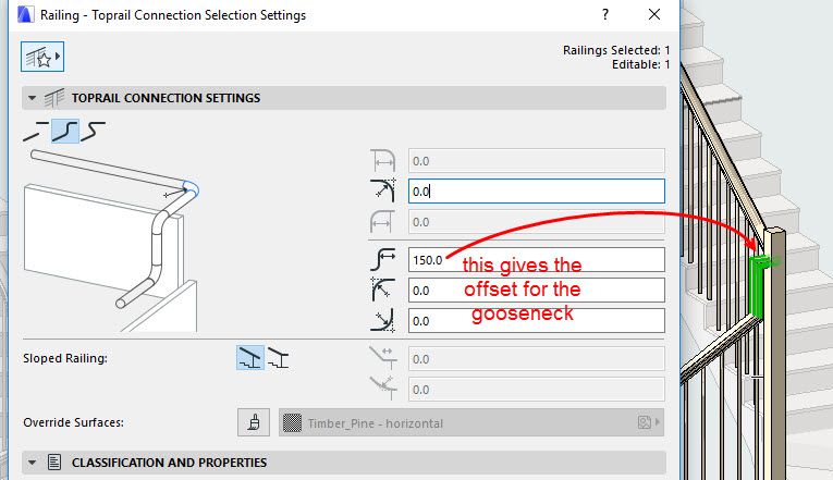

This is all I did for the gooseneck settings.

Hi Barry, really appreciate your tips. Following your detailed explanation, I managed to replicate the gooseneck effect, though it's definitely not an easy task. The order which you add and elevate the two nodes yields drastically different results, I'm trying to figure out a systematic way that produces consistent results. A key point is that the two nodes musn't land on top of each other, otherwise they merge into one, a 1/32" spacing will do.
However, while the 3D looks fine, the 2D representation is bad: the break line and railing outline are hidden, I'm trying to get it to display properly across two floors...
It would be nice if ArchiCad can optimize winder railings since they're so popular.

Then you offset the gooseneck so it runs down in front of the post.
That is the only figure I altered in the gooseneck, the height or drop comes automatically from the railing base node heights.
