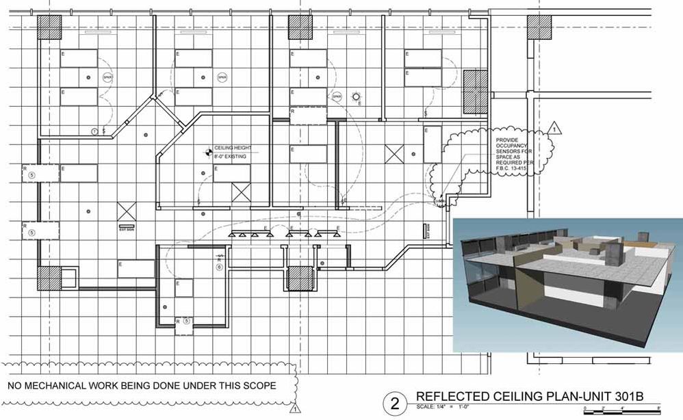

here's what I'm talking about "graphically" for those of you who need to see.
a picture truly is worth a 1000 words....how much would a video then be worth?

rob2218
Finally the image size made it uploaded sheesh!!!
here's what I'm talkin' bout.
the grid associated to the slab ceiling object is vectoral in 2d plan...but I can't click on the intersection of the line work??? why not is beyond me.
So I either have to 2d the lines in the plan RCP view or....what???

Dennis Lee
1. Show the "Fill Handles" from "On Screen View Options"
2. Start placing them at the origin and move them around in multiples of 2'
or
2. Set your temporary origin to the fill handle and set the grid snap to 2'.

Laura Yanoviak
or
This is our practice. Although it would be nice to be able to click on the intersections of ceiling grids, I'm glad AC doesn't snap to vectorial hatches the way ACAD does -- that was more bother than convenience.

rob2218
"NOT" being able to snap to two basic intersecting lines is ridiculous.
I'm not asking and no where did I ask for ALL the hatch patterns to be "snappable" to.........i'm merely asking for the a typical (which there are millions of commercial and residential work here in the U.S. and Internationally) samples where the intersecting lines of a 2x2 or a 2x4 ceiling grid would be of most benifit and time savings............NOT ALL THE HATCH PATTERNS need snaps to them.
I mean seriously folks...a 2x2 ceiling grid is typical very typical in construction.....

Dennis Lee
I understand your frustration. One thing I learned over the years with AC though, is that if you keep questioning WHY, then it will get you even more frustrated. Unless you are a programmer and take things into your own hands by developing an add-on or something, it's much more productive to ask HOW, then just do it. This placing lights and grilles at the correct location might seem very stupid and harder way to do it, and it may be, but there are far greater benefits of using ArchiCAD in the overall process. After a while, you'll soon get used to it all and will think why you were frustrated in the first place...
From the programmer's point of view this ia not a simple matter. Programming for special case conditions leads to cumbersome, complicated and difficult to maintain software. Many of the complaints we have here in the forums are due to just such decisions made in long ago to accommodate the hardware limitations of the day.
Realistically if GS were to implement this it seems they would have to enable the snaps for all vector fills or they will be buried with complaints from all the folks who want it for some purpose other than ceiling tiles. Practically speaking this means there needs to be a function to turn this feature on and off in a way that is convenient to its use.
This could be the keyboard toggle as I described before, or perhaps a new setting in the fill attributes to enable snaps for specific fills.
I am just suggesting a way that this could be done. I really don't understand your heated reaction.
You are also ignoring the more obvious solution of simply having a proper ceiling tool instead of cobbling them together from slabs and roofs and other bits.
Dennis Lee
BTW, off topic, if those partitions continue past the ceiling in section (as shown in the 3d view), shouldn't you have your grid separate for each room? Or are your partitions anchored to the bottom of the ceiling grid only?
