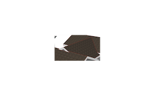

Is this the desired effect?
toman311
Yes, how can that be done?

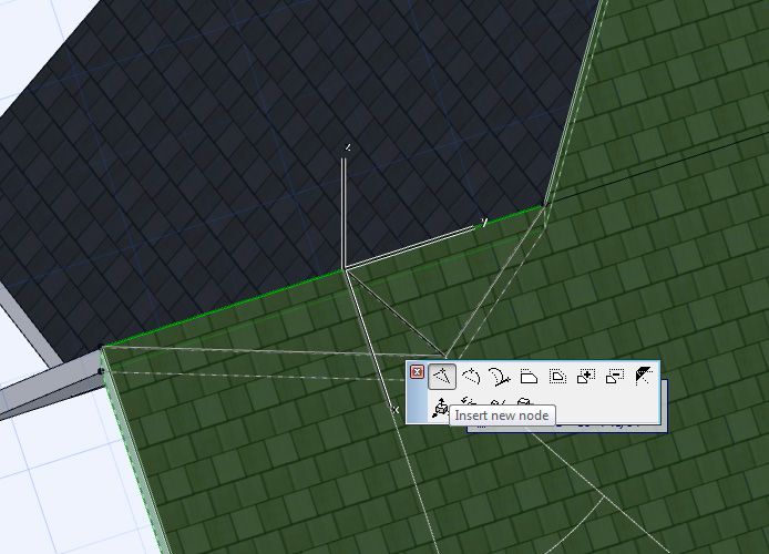

Does the pet pallet not appear when you click on your roof's edge? That's how you can enter nodes; by selecting the first option on the pet pallet: insert new node, you can then modify how your roof is shaped. Also: you do not need to click the intersection to generate the node. Create the node along the ridge line of your roof and then move it till it intersects the opposing gable.
toman311
When I click on the roofs ridge, this is the pet pallet that I receive...
[Drag Horizontal Ridge] [Elevate Horizontal Ridge]
[Drag] [Rotate] [Mirror] [Multiply]
Hmmm...I'm clueless.
