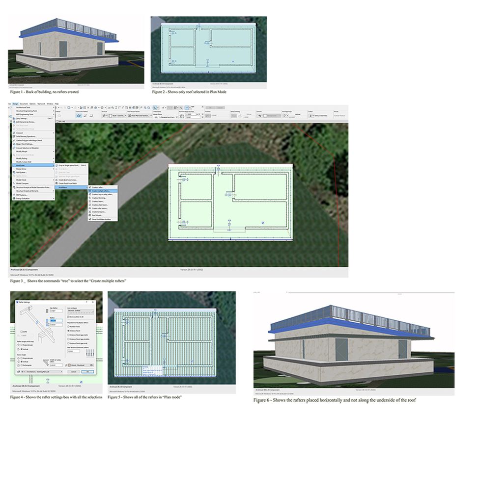

I recently submitted an issue I was having with the Trusssmaker tool to which Karl O was nice enough to provide some feedback. So instead of a truss I decided why not just use rafters of a necessary size and optimal spacing. After reading through all of the instructions on creating a rafter(s) I did the following. I first selected the roof in the layout mode. Next I selected "Design, Roof extras, Roofmaker, Create a rafter) and the rafter details window pops up. I set all of the options to what I need and finally click on OK. I am now requested to select a point anywhere inside the area of the roof to place the rafter which I do. I next opened the 3D view and to my surprise the rafter is in the spot selected but instead of following the underside of the roof it is horizontal to the ground. Can't understand the result as I did everything as stated in the AC help documentation. Don't know what I did wrong. All help appreciated. Regards

I can't see any issues with Roofmaker as you described and wonder if you're sure that just the roof was selected, and not perhaps a ceiling that was modeled with the roof tool?
I magic wand-ed a hipped roof around an L shaped slab, selected the roof, used the Roofmaker Wizard with default settings, and everything was created as it should be.

Hello Karl:
To make it easier for you to understand what I am doing I have included a picture of the steps I took and the end result. Please note that the roof was created using the roof tool. In figure 1 you will see the back side of the building (halfway house on a golf course), the roof is blue and you will see that there aren't any rafters under the roof. Figure 2 shows the selection of only the roof in plan view. Figure 3 shows the steps taken to get to the "create multiple rafters" tool/window. Figure 4 shows the selections I made for my application. Figure 5 shows the rafters in the plan view. Finally figure 6 shows a picture of the back of the building (3D view) and the result which shows the rafters place horizontally and not along the underside of the roof. It's like AC thinks the roof is flat which it isn't.

It doesn't appear that I did anything wrong.

regarding the first part, can you see where I went wrong? Thanks and regards.

I can't reproduce what you show.  (I can't read everything that you posted due to low res - but good enough.  Thanks for making such detailed screenshots.  In future, drag each one individually - no limit to quantity - into your message so that they can be full res/readable.)
Beams run with the slope of a roof, so it is odd to see your beams run parallel to the slope... although they aren't sloping, which is the issue.
Again, I find the Roof Wizard  works fine on this - but get the same result with the Create Multiple Rafters.  Of course, RM falls down on understanding the parts of the roof that overhang the structural/supporting walls - as it will generate rafters that just hang in space. There would have to be lookouts for the north/south edges penetrating well into the building where a joining rafter would have to be doubled up or even beefier.  And either the rafters would have to be beefy, or there would have to be an intermediary beam for the long room on the bottom right of your plan view.  RM doesn't understand structural loads - just tries to give a starting point for preliminary design visualization pending the engineer's plan.
