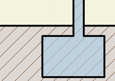

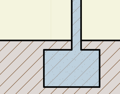

Morning everyone

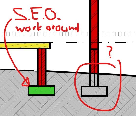

I've recently upgraded my AC25 file to AC26, did a bunch of work on it, and only now realized that the intersection priority for all my walls and meshes is broken in section. The mesh always hides the wall and foundation cut fills, leaving only the outlines, regardless of the strength setting of the material.
I've tried resolving it by fiddling with the intersection priority of both elements, moving elements forward and backward, creating new elements, but nothing works.
Starting a new project using a template created from this same file does however produce the expected behavior. No problems.
The only work-around I found is to use solid element operations on the elements, but this produces poor quality line thicknesses and is quite cumbersome to do, and will need to be redone anytime I split or duplicate the mesh.
Is this a known issue?
Does anybody have a good workaround?

What happens if you select the Mesh and then use Edit -> Display Order -> Send to Back?
FWY Priority Based Intersections do not work on Meshes…

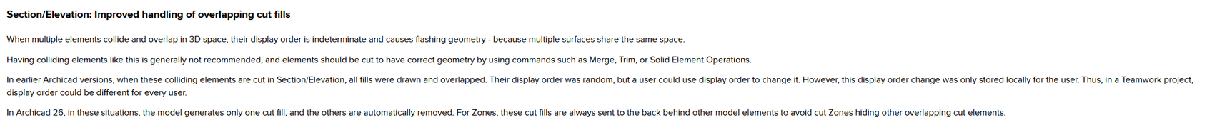

I think the problem comme from that:
Is there a solution to have the same display that in AC25 ??
It's sutch problematic, i have to do a lot of modification if there is not a quicly solution...

It is not broken, I just did it on a new file in 26 and an imported one from 25.
Just send to back the mesh, no SEOs.
The only time I have seen something strange is when using GOs

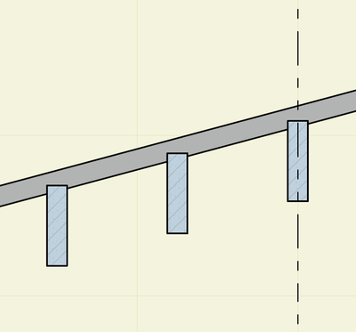

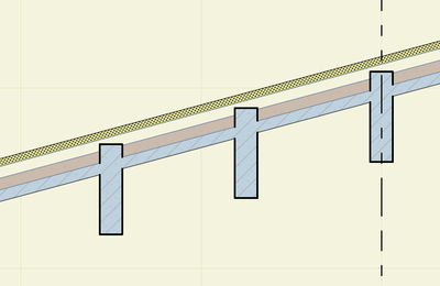

In AC 25:
When Modeled
After sending the mesh to back
Open the 25 file in 26 and you get

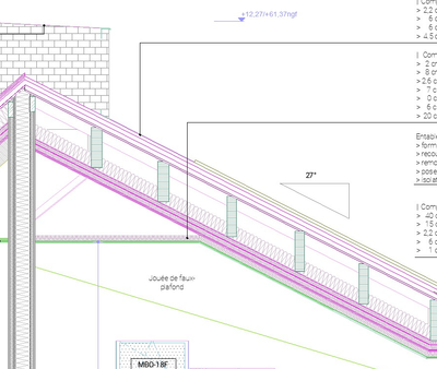

New test today:
> screenshot of cut portion on AC26:
You will notice that the wood beams (materials with a higher priority than the others, layers with a higher priority than the others) are not displayed correctly, except for one, which is however in no way different from the others... No effect of the "order" commands display"
> I saved the projects in version 25 and opened it on AC25, and there everything is in order:
And here we do this on several files migrated from 25, systematically when complexes overlap (here the roof and ceiling complexes and the beams)
Sorry for my english (google traduction...)

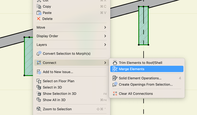

In 26:
Using Sent to Back (the one in the middle didn't work, need to bring it forward)
Using "Connect -> Merge"
Changing the roof to a composite with different BMats
