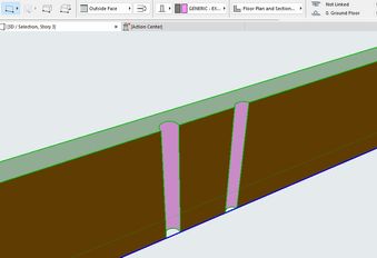

Hello everyone.
I have an issue.
I'm in archicad 27.
I have two thin columns that I want to use to have a groove in the wall.
The two columns have a building material with 900 priority. The wall has  a building material with a lower priority.
The wall and the columns are on different layer with the same intersection number, so PBC is active.
When I switch off the layer of the columns I see correctly the missing volume of those columns but the surface of this part of wall is not under my control. I don't understand the reason of the used surface for the missing volume faces.
I prefer using PBC becasue is practical in the workflow compared to boolean operations.
On the other hand with SEO I can control the surface.
Any help is appreciated. Thanks

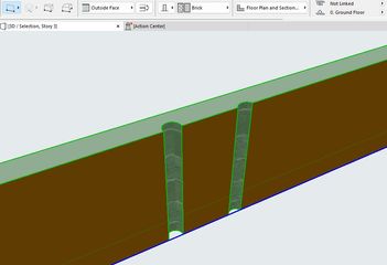

The surface of the "cut" is the building material of the wall. I replicated your situation and I can see the inner grooves changing based on the building material of the wall:
And it works with composites too.

Thanks!
I did some similar attempts but probably I was under graphic override and I didn't notice what you mentioned. You're right!
Thank you very much
