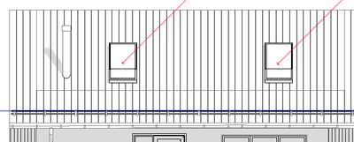

How to remove the outlines between 2 overlapping roofs?
In the process of learning, thank you for any patience required.

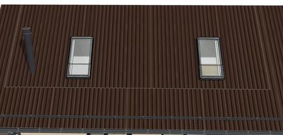

So there was an instance that required a thicker section of a roof for insulation. The way they did it was to make a copy of the roof, size it for the indoors part, edit the thickness and reposition against the original roof, and then they did a solid element operation > subtraction with upward extrusion. Hopefully I didn't miss a step, had to reproduce later on my own.
But effectively got the windows to not look strange and the roof is in position, but this generates outlines between the 2 where simply removing outlines will not make it any better. Is there anything that can help here, or is this version of the software they use(Archicad23) too old for that?

Without any holes in it, wouldn't the windows look questionable in 3D?

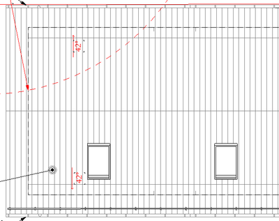

Here's the cut, hopefully makes it a bit clearer what is currently going on.

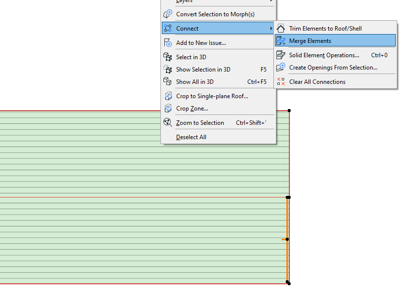

merging the roofs should remove any unnecessary lines
