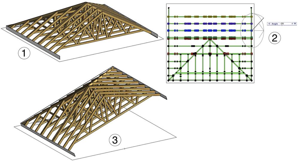

Try OBJECTiVE. It will allow you to rotate any number of objects around a common pivot line, and also provides rotation in elevation/section windows. Referring to the attached image:
  • 1) A selection of trusses to rotate, all constructed of individual parts for scheduling, i.e. the truss is not an object.
    2) In plan, select the objects to rotate and click the menu OBJECTiVE > Tools > Rotate. Click twice to define the rotation axis, and then click (or enter) the rotation angle. In this case, I'm rotating back by 20 degrees.
    3) The finished result in 3D
Note how this method will allow you to rotate an entire collection of different objects simultaneously about a common axis.
