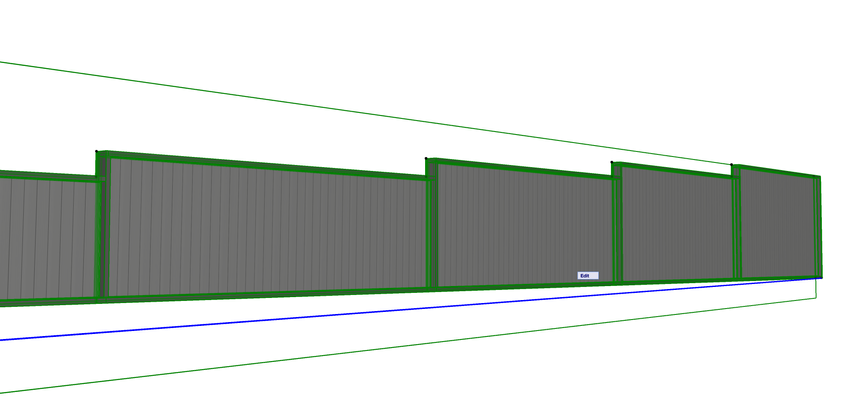

The tricky part is the connection at the top and the alignment of the grid.
Apple M1 Max 32 GB Ventura
AC27
Yeah cool nice work. I have to be able to stagger the bottom as well and that wouldn’t be much of a problem with a few edits.
I would just use a group of components with the CP column and beams with normal columns to make a module. Then just replicate the module and drop them in height as they go down the slope.
