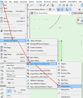

Hi all, I am wondering how I can save a custom metal fence panel created with the complex profile extruder into the library. I want to be able to access this custom panel from the railing UI to add it into my railing design. Is it actually possible without using any GDL scripting ?

You can save a custom railing panel.
But from my experimentation, you must model it standing up and exactly the size you want the panel.
It will not re-size to suit the railing, like a custom door leaf does for a door frame - unless I have missed something.
So it is only good for a railing with a fixed panel size - i.e. fixed post to post distance and top and bottom rail heights.

Hi @Barry Kelly, Yes I will have a fixed panel size for the main part of the fence. I can always make different sizes for odd parts of the fence panels. I might have to use the CI Objective tool to stand the complex profile sheets up or find some other way to do it ?  I have created the railing already I just want to insert the custom sheet profile into it.
Thank you for the library saving method above.
