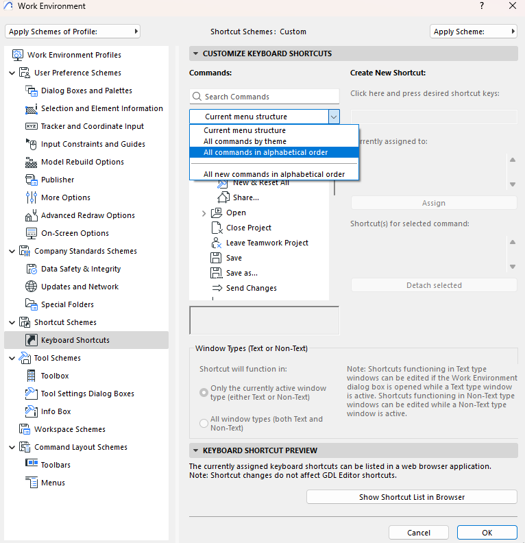

When I search under "All commands in alphabetical order" I found the relevant command !! Thanks for help:) Otherwise it does not show.

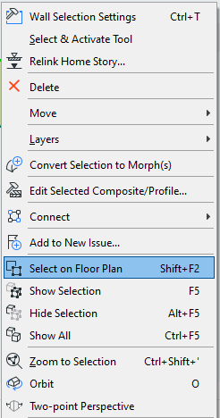

For me there's a shortcut setup as "Shift + F2" in AC28 INT.
Does that one not work for you? Or which AC version are you using?

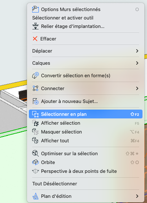

In the French version it's the same shortcut
If there's none in your Archicad version you can set one in the work environment.

Could you be using a Work Environment from an older version of Archicad where that command did not exist?
scottjm
Mentor
This was added in 25 or 26.
You could just re-apply a standard Work Environment profile.
That will have keyboard shortcut already set up.
But of course you will lose any customisations that you have made.
Adding this shortcut to your profile is fine, just be sure to redefine the shortcut profile so it is not 'Custom'.
