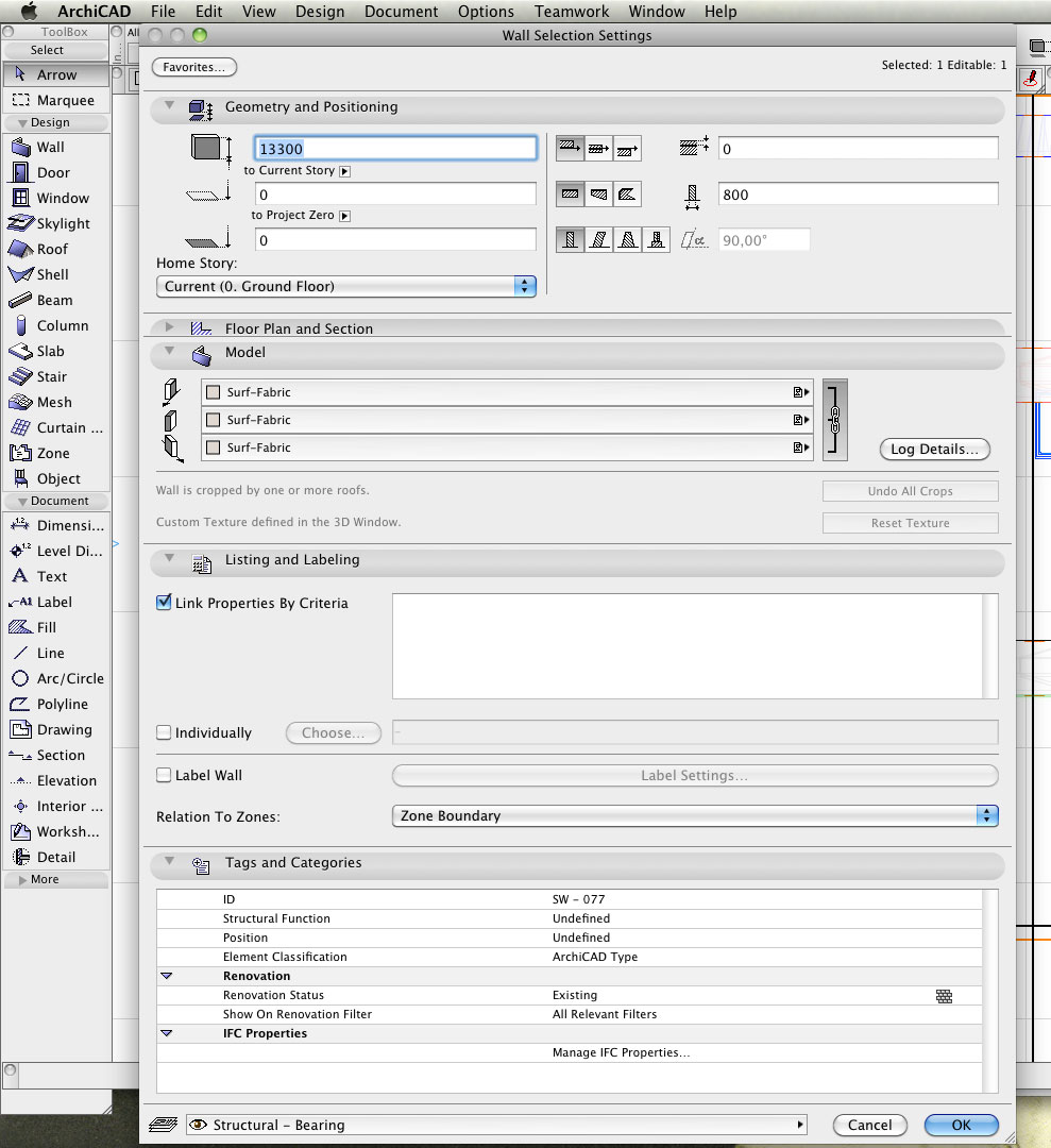

Can you do a screenshot of your wall settings?
Here's screenshot 1
Kindly
Fredrik
.. and 2
The surface you have selected for the wall is "surf-fabric". I think this may be causing the funny texture. Please try changing that to a solid color or something else.
This should have fixed it, correct?
Thats what i thought too but after testing with all kinds of surface material and other settings (incl solid colors) i have no idea. Nothing changes this random behaviour. I have created several walls and other objects and many of them have the same settings, still some of them have this problem. Maybe its a bug or something, i have never seen this before in earlier versions of archicad.
