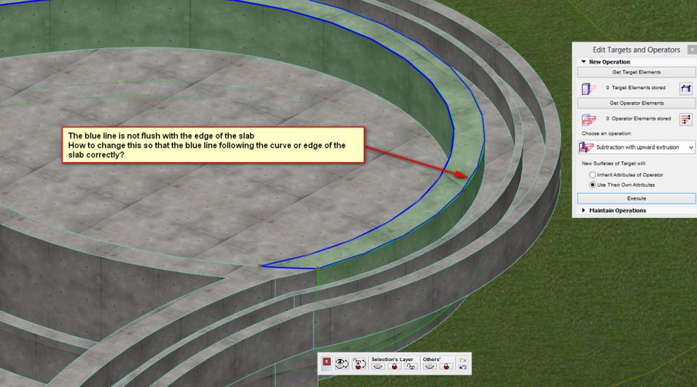

Slab in AC17?
How to change this so that the blue line following the curve or edge of the slab with smooth and parallel?
Thanks

Those line segments are controlled by the magic wand settings. Play around with them under >Options > Magic Wand Settings ...
If you use the curved wall tool instead of SEO, you won't see those segments.

I do it manually without SEO or Magic Wand (Space + Click) to make changes to settings Magic Wand was no effect or bring about change
Eddy,
What problem are the editing line segments creating for you?
They do not seem to appear in a rendering or the print out.
You are right about the magic wand- no effect all. There are more segments on a large circle and fewer on small circles,
with 8 segments being the minimum, no practical maximum I can see. Probably GS's way of keeping the number of polygons
from getting out of control. Curious though, that so many curves are controlled by the magic wand value, but not this one.
Sorry for the miscue... However, why not use the wall tool?
