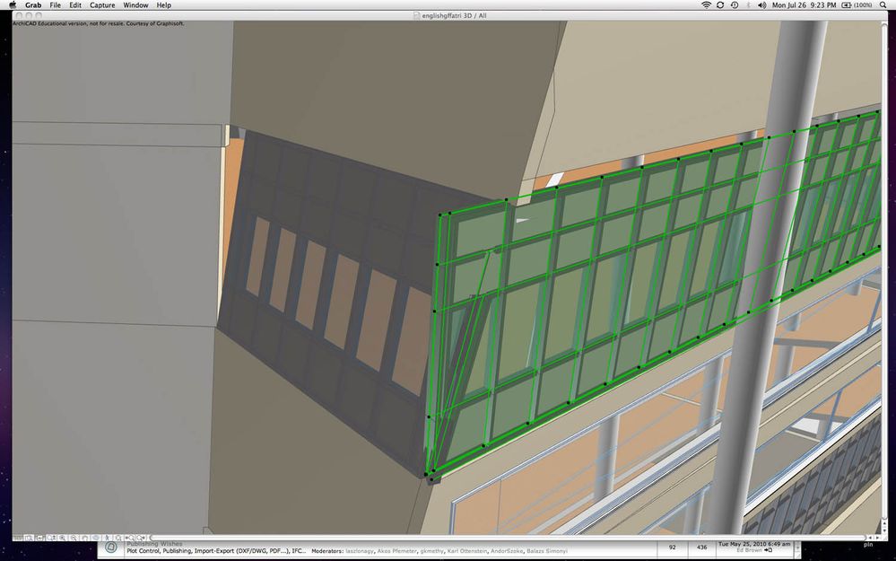

I've tried to get these two corners to connect but i cant seem to get it. I've even given up and tried to just put windows but the curtain wall seems like its the way to go if i can ever get it to work. I've slanted the two curtains now i just need to trim that extra off. if you would please help me out brand new to archicad. I've tried to go into edit and erase them and it doesn't erase

Choose the curtain wall and go to Edit mode. From there switch on Scheme and then just select the Scheme and drag its corner where you need to.

K i did that but there is sill that extra corner. i need that corner flush with the other
nevermind got it. thanks lol you just made my day! been trying to fix that forever
