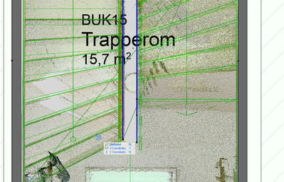

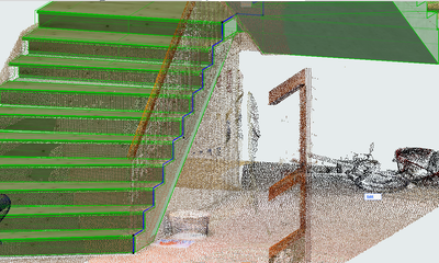

Stair structure could not be edited? Any other suggestion besides turn off structure or to beam?
I need to make stair according to pointcloud
If I turn off structure then it would not be correct.
Hope to get better solution. Thanks a lot
2 Replies 2
ryejuan
Stairs in Archicad is not that straight forward in my opinion. The first thing you need to get are the correct measurements of your point cloud stairs, I notice at the first image is that your treads are extended beyond your risers. Key in first the correct measurements before you draw the stairs. Take note it is also important where you place the reference line (BLUE) of your stairs (internal or external)

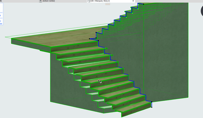

the stair I am working on look like this
So I edit the finishes but the structure do not follow along. Thus the first picture you see in my first post. So my question is, is there anything I can do to 'edit' staircase structure?
