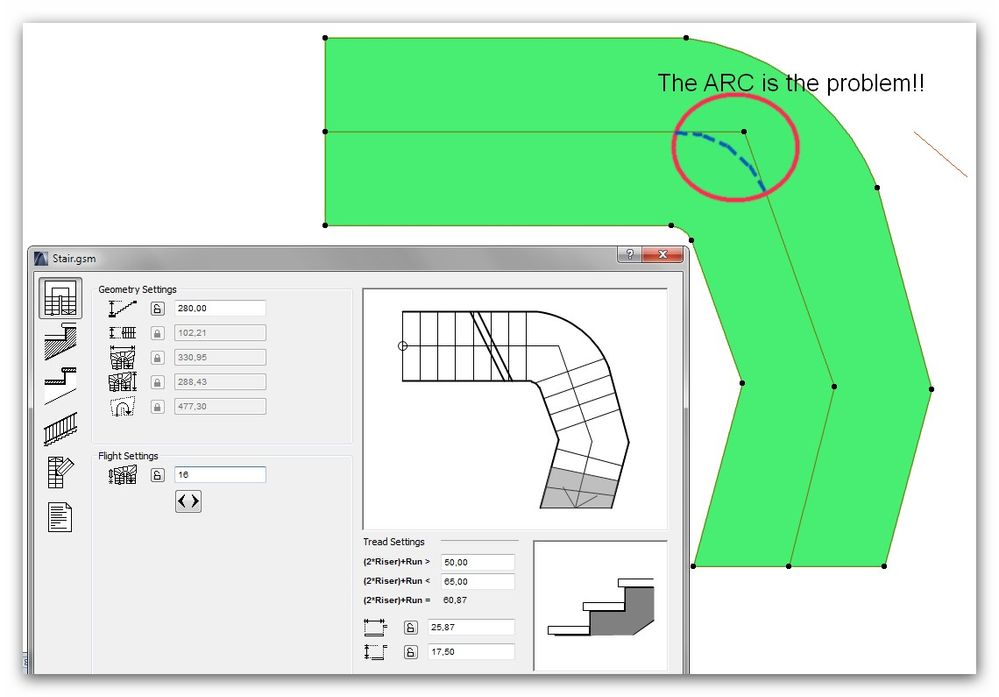

I am trying to create a somewhat special stair with the stairmaker, but a window pops up saying "cannot generate stair with this line of travel". I have no idea what I have to do to make it work.
12 REPLIES 12
The line of travel MUST be made with LINES segments ONLY (in yours case 4), not with Polylines tool!!
And delete those 2 angled lines on the end.
"Cannot....." message is caused by second segment of the travel line (arc).
Change it to the straight line.
Thanx a lot, the arc was the problem indeed!

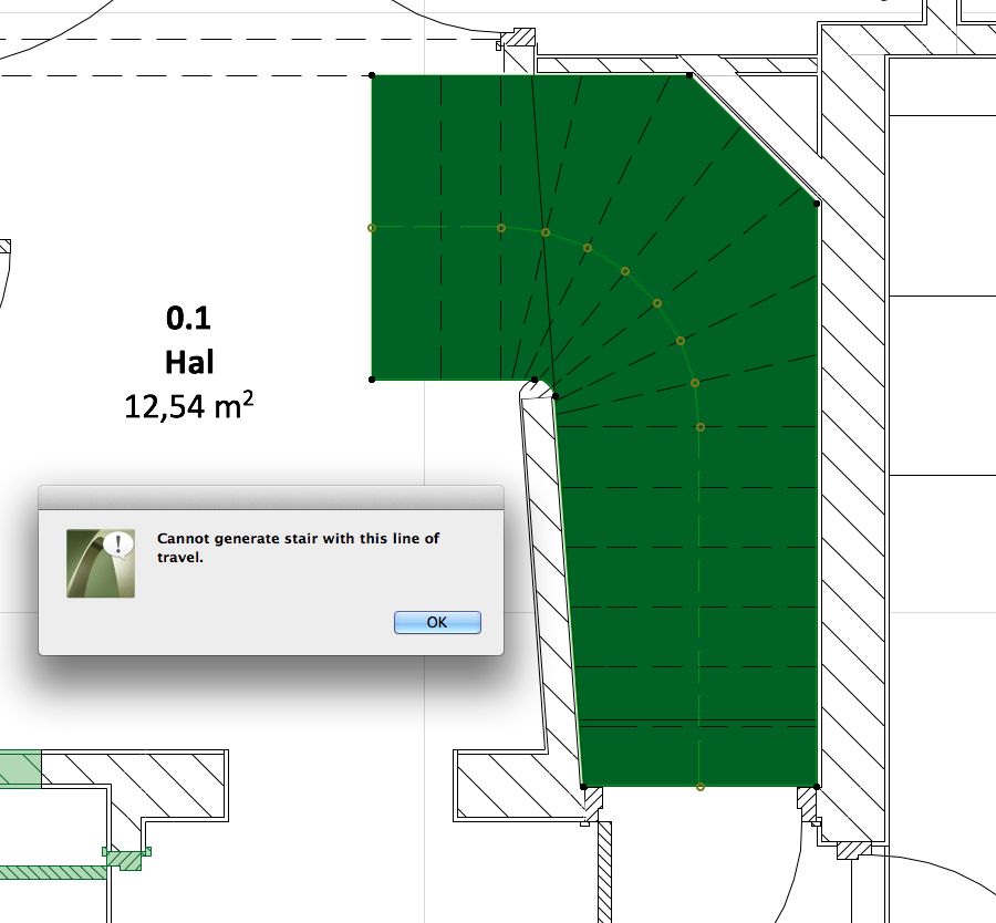

Hi, I am trying to make a different type of staircase and also get the "cannot generate stairs with this line of travel". However, in my case it is not possible not to use an arc in the line of travel, as it needs to be two stretches of straight steps, connected by 90 degrees of winding steps.
This is for a renovation project, and I'm virtually recreating an existing staircase. Therefore I have no artistic license to make the stairs work in a way that suits the software.
I use Archicad 16
The line of travel is made by 2 Lines and 1 Arc??
I tried with: line-arc-line
I also tried with: Line-7lines(used as segments)-Line
This is what I get with AC16:
