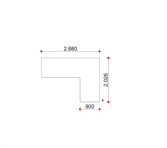

Sorry if this appears to be a copy of my previous post, but I have realised that I did not ask the right question.
I would like to replicate the stairs as presented in the attached drawing, as this is what will be supplied by the stair manufacturer.
I am having problems getting the results I want from AC stairmaker.
Can anyone advise me the best way to replicate a stair like this? For example, AC doesnt want to give me 3 stairs on the turn and in the same manner.
Is there a way to magic wand a 2d outline if I draw out the dimensions of the staircase I want??
Thanks

1 ACCEPTED SOLUTION
Solution
cuba
You can change the number of goings in afterwards in the petpallet menu.

Hallelujah ! Thank you very much for that very clear explanation, worked perfectly.

Or you can set it in the stair settings before you place the stair.
