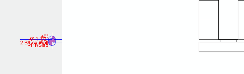

is there a setting or work around to avoid the text story conflict as shown in image?

Solution
You can adjust the text size ...
https://community.graphisoft.com/t5/Documentation/How-to-avoid-overlapping-level-markers-in-elevatio...
Or you need to find a 3rd party storey marker that is more adjustable such as ...
https://community.graphisoft.com/t5/Documentation/Story-Marker-Staggering-Offset-Move-left-and-right...
1 REPLY 1
Solution
