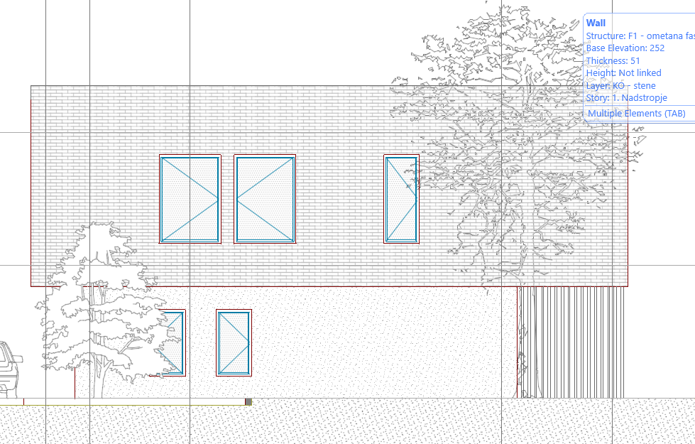

Can someone help me with this problem? I inserted trees in elevation - 2D. If they are in the front (display order), it's okay, but when I want to send them to the back, you can still see all the lines.
In AutoCAD, you have a neat tool for that - the Xclip boundary tool, that makes trees partially disappear - how you want them. Does archicad have similar tool?
Thanks!
I attached a screen shoot of the problem. The first tree is in the front and the second is in the back.
1 Solution
cuba
Make sure you have a uniform pen - color fill with a white color.

Thank you! That solved it
