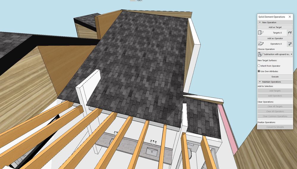

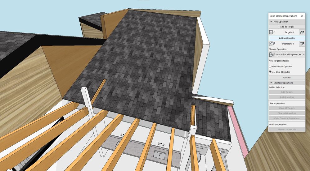

Hello. I have read through the forum for two way roof slope. I have created the roof using the beam tool. I created two - one roof and one which would be the sheetrock on the inside. This is so that I can show the layers in the section accordingly and also show the framing members in between. However, I am now encountering the problem of cropping items to the "roof". First, the crop function does not work with a beam.  So, I changed the beam to a morph and the crop function still does not work. So, I went to solid element operations and selected the morph (roof) as the operator and the walls I want to crop as the target. The only tool that works is subtraction with upward extrusion. However, this leaves voids in my top roof layer. Please see the images attached. Any ideas on how to avoid this?
