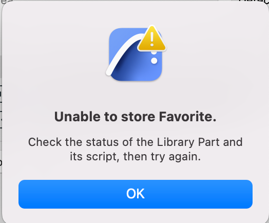

When saving a favorite i get this message:
"Unable to store Favorite
Check the status of the library part and its script, then try again."
Does anyone have any idea what the problem could be here?
I can't save favorites for library parts from the stock Archicad 26 library when my library is uploaded to BIMcloud.

I’ve never come across that error before. Could it be a communication issue with BIMcloud?

It's got to be a migration thing, but I don't know what.
If I open a new file from the stock Archicad template, delete the 26 library, and import the BIMcloud 26 library, I can save favorites. So it's not a BIMcloud or library issue. All my projects that started before 26 (all of them) can't save favorites.

Ok. Migration doesn’t work for BIMcloud libraries. You will see there is a broken link icon if your go in to Library Settings. You will need to remove all of the Libraries loaded from the BIMcloud Server and then add all the new AC26 versions. BIMcloud Basic only supports one version of AC which means AC can’t automatically migrate the libraries. It normally adds local versions of the AC26 Library and the Migration Libraries which will need removing and replacing with the BIMcloud ones.
